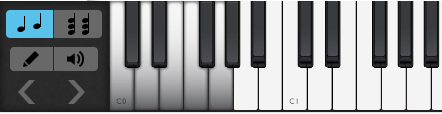

(1) One way is to use the keyboard that NOTION 6 provides, which initially looks like the following image:
When it looks like this, you can click on notes and hear them; but nothing is input to the selected staff. . .

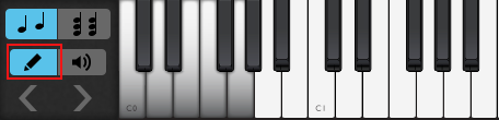

So, when you want to input notes using the keyboard, you need to click on the pencil icon, which puts NOTION 6 into input mode:
NOTE: I drew a red box around the pencil icon to make it easier to find . . . ]
This will cause a note to be input each time you click on a key; and the note will be a quarter note unless you change it so some other type of note, for example an eighth note or a sixteenth note . . .
The staff where the notes are being input will change to a yellow-tan background . . .
When you are finished inputting notes, click on the pencil icon to end the input . . .

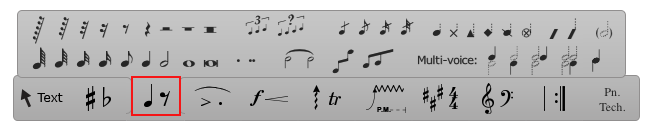

(2) You can use the Tools Palette to select a type of note, which changes the mouse pointer; and then you use the mouse pointer to click on a staff where you want to place the note . . .
Once the mouse pointer is set to a type of note, it will stay that way until you press the "ESC" key; so you can use the mouse pointer to enter a lot of notes, not just one note . . .
NOTE: I drew a red box around the Note tab of the Tools Palette to make it easier to find . . . ]
First, you click on the Note tab (
see above); but then you need to click on the type of note you want to input (whole note, half note, quarter note, and so forth) . . .
This is explained in the NOTION 6 User Guide starting on page 8.4, and there is more information on dotted notes and lots of other stuff pertaining to this type of inputting notes, which is called using the 'Entry Palette", since these things need to have unambiguous names . . .
