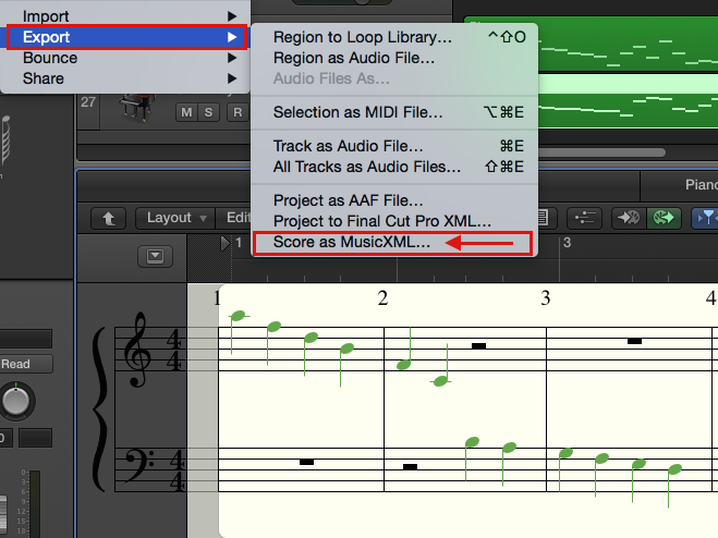

STRATEGY ON THE MAC WITH LOGIC PRO X: EASY AND FAST
If you are doing digital music production on the Mac and have Logic Pro X (Apple), then there is an easy way to split notes from a single staff to a grand staff when the MIDI file has all the notes on a single staff . . .
(1) Import the MIDI file to Logic Pro X . . .
(2) Double-click on the resulting MIDI sequence to switch to the MIDI sequence editor . . .
(3) Click on the "Score" button to switch to music notation view, which automagically converts the MIDI sequence to music notation and does the grand staff split so that treble notes are on the treble staff and bass notes are on the bass staff . . .
The split is done with "Middle C" (C4 in standard scientific pitch notation) as the split point, so notes from "Middle C" and higher will be on the treble staff and notes lower than "Middle C" will be on the bass staff . . .
(4) Click on the "Edit" menu and then click on "Select All" to select all the notes for the MIDI sequence you just converted to music notation in Logic Pro X to do the split . . .
(5) Click on the "File" menu and then click on the "Export . . ." menu item, which causes a fly-out submenu to appear, where you will click on "Score as MusicXML" . . .
(6) Close Logic Pro X, and start NOTION 5, where you then will import the MusicXML you just exported from Logic Pro X . . .
This is the NOTION 5 Basic Staff I used to create the MIDI sequence, which I exported from NOTION 5 as a MIDI file and then closed NOTION 5, followed by starting Logic Pro X and importing the MIDI file:
NOTION 5 ~ Basic Staff ~ Original Test Data
This is the imported MusicXML created by Logic Pro X and then imported to NOTION 5, where it is assigned automagically to a grand staff with the split point at "Middle C":
NOTION 5 ~ Grand Staff ~ After Split by Logic Pro X and MusicXML Export-Import
