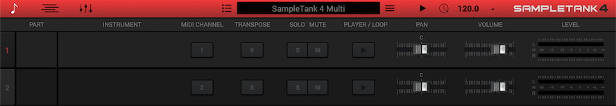

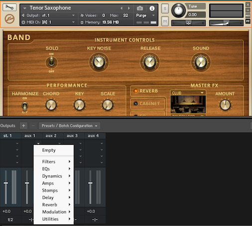

acequantum wroteThe advantage of the DAW is of course setting levels, pan and effects processing per track or project - but at the cost of maybe more CPU. Most standalone virtual instrument engines provide the ability to set volume levels, panning, effects, and so forth for each instrument . . . ![]() THOUGHTS I used "most" only because I do not have every virtual instrument engine available . . . The ones I use here in the sound isolation studio all have mixers that provide the ability to set volume levels, panning, effects, and so forth . . . SampleTank 3 and SampleTank 4 (IK Multimedia) have extensive per instrument control for volume levels, panning, effects, and so forth . . . IK Multimedia also sells VST effects plug-ins, and these can be used with the IK Multimedia standalone virtual instrument engines . . . ![]() SampleTank 4 Mixer ![]() SampleTank 4 MULTI Editor [NOTE: The IK Multimedia FREE software is a lot of useful stuff--more than enough stuff to do the instrumentation for a Pop or Heavy Metal song, when used with a DAW application . . . . . . ] IK Multimedia FREE software, including SampleTank 4 Custom Shop (IK Multimedia) This is the Kontakt 6 Mixer Panel and Info Panel for a Tenor Saxophone . . . [NOTE: Native Instruments also sells VST effects plug-ins, and when you purchase them they appear in the list of Effects available in the Kontakt Mixer panel. If you subscribe to the Native Instruments newsletter, they occasionally proved free VST effects plug-ins and other good stuff, where for example the Replica reverb unit was a free gift for email subscribers, and it's a nice reverb unit that does different types of reverb but also echoes like the Haas Effect. Native Instruments provides a useful gift every three or so months, which is nice, and they also provide notice of discount sales, which is very important when you want to get the most VSTi virtual instruments, sampled-sound collections, and VST effects plug-ins at the lowest cost. Over the past few years, they have had 50-percent discount sales of Kontakt at least once a year, typically during Thanksgiving Holiday week or month, which saves about $200 USD on the full price. And like with SampleTank, you can create MULTIS with Kontakt . . . ] ![]() Kontakt 6 Mixer Panel and Info Panel for Tenor Saxophone [NOTE: Komplete Start is a FREE bundle featuring a lot of stuff, including synthesizers, players, instruments, and so forth--more than enough stuff to do the instrumentation for a Pop or Heavy Metal song, when used with a DAW application . . . ] Native Instruments FREE software, including Kontakt 7 Player and Komplete Start (Native Instruments) [NOTE: The FREE software (IK Multimedia and Native Instruments) requires you to create and register an account (FREE); and this also adds you to their email lists, so you get notifications of discount sales, more FREE stuff, and so forth. They do not flood you with emails--just occasional emails with useful information, perhaps one email every week or two or perhaps one email a month, depending on whether there are updates, discount sales, and so forth. It's a smart way to learn about discount sales and product updates, which over time saves money to spend on getting more stuff. Many digital music production software companies have FREE stuff and email newsletters, plus occasional discount sales. It's the smart way to get the most stuff with the money in your budget at the lowest prices . . . ] SUMMARY As noted, I think most standalone virtual instruments have options for setting volume levels, panning, effects, and so forth, as well as saving groups of instruments as a MULTI, including each instrument's specific volume levels, panning, and effects . . . Depending on the specific VSTi virtual instrument and its standalone version, a MULTI can have as many as 64 instruments, although it's more standard to create MULTIS with up to 16 instruments . . . The advantage is that you can create a MULTI for an ensemble of woodwinds, brass, strings, and so forth, where for example one instance of SampleTank 4 can be a MULTI for an ensemble of woodwinds, with 16 woodwinds each having its own channel . . . The more elaborate a MULTI is, the more processing overhead it incurs; but doing a set of experiments should help determine whether the additional processing is a problem for real-time, live performances where NOTION is running the show for augmenting, enhancing, or replacing real instruments with a set of virtual instruments . . . Again, the same caution applies, which specifically is that the combination of NOTION and its native instruments is designed specifically to work with NTempo in live performances . . . NOTION is optimized for this specific usage, which includes optimizing the NOTION native instruments for efficient and flawless processing in live performances . . . Yet, I am not suggesting other standalone synthesizers like SampleTank 4 and Kontakt 6 are not optimized for live performance usage . . . Nevertheless, I am suggesting two things about NOTION: (1) NOTION is designed specifically for use in live performances. (2) NOTION is optimized, tested, and verified for this purpose. Of course, NOTION does other things; but NOTION is unique in its ability to augment, enhance, and replace real musicians and instruments with music notation and virtual instruments under precise control of NTempo . . . Lots of FUN! ![]() P. S. I strongly recommend doing this on the fastest Mac you can afford; and I recommend the Mac, because it is more stable than a Windows computer for this purpose--especially if you are unable to configure a Windows machine to prevent show-stopping annoyances, where in fairness there also are things that need to be configured when you are using a Mac, more so a new Mac with Apple Silicon and all the enhanced security nonsense when during a tranquil musical interlude performed before a live audience you want to avoid having Siri ask whether you changed your underpants or something equally absurd, which is fabulous . . . Fabulous! ![]() P. P. S. Regarding creating your own sampled-sound libraries, SampleTank and Kontakt do this . . . . For example, if I want to create a sampled-sound library for my whammy guitar sounds, then I begin by recording each note, one-at-a-time per pitch for several typical durations ranging from 1/32nd to a double whole note with all points in between . . . For example, start with "Middle C" (C4 in Scientific Pitch Notation) and record a C4 pitch note for each duration {1/32nd, 1/16th, 1/8th, . . . , 1, 2, 3, 4, 8} . . . The in-between durations can be constructed by addition or actually recorded to provide more detail . . . There can be "whammy" notes that start at standard pitch but go downward or upward in various motion patterns . . . Whether it's elaborate or simple depends on what you want to do; and it can include upward and downward string bends like the native NOTION electric guitar . . . Then using Audacity, edit each note sample (audio clip) and trim the attack and release to focus the resulting audio clips on the actual note recordings, excluding leading and trailing studio noise and so forth . . . Save each note with a specific name that includes information about the pitch and duration of each note; and put all the edited audio clips in a common folder . . . Next, import the audio clips to SampleTank, and SampleTank makes the sampled-sound library, which then can be used in SampleTank when I want to have virtual electric guitar whammy sounds . . . In fact, this is why the product is called "SampleTank", where "Sample" is a clue to one of the capabilities of the software . . . Kontakt extends this capability to include providing scripts for sample-sound libraries; and Realivox Blue (RealiTone) is an example of this, where it's a third-party product that runs in Kontakt and provides a virtual female soprano who sings the phonetic scripts you specify . . . ![]() Realivox Blue (RealiTone) [NOTE: This is the song I used to make sense of Realivox Blue scripting and vocal singing control; and it's best enjoyed when listening with studio-quality headphones or Apple AirPods. The theme is a parody of the classic Nirvana song "Smells Like Teen Spirit" which was inspired by a teenage antiperspirant. In the parody, sometime in the future cyborgs are so lifelike that the only way to distinguish them from humans is to taste their skin, since it tastes like AXE® "Anarchy" antiperspirant, deodorant, and body wash. The pattern for the lyrics is "<pronoun> taste like Anarchy", where <pronoun> is {she, you, I, we}. This took about three months, and getting the word "taste" to sound human required using the Melodyne Editor (Ceremony) to add and reinforce leading and trailing consonants, sibilants, and all the stuff, which is fully documented in the "Project: Realivox Blue" topic in this forum (see link below). For reference, I focused on specific words that are difficult to humanize, even with Realivox Blue's intimate phonetic scripting and the Melodyne Editor. Along the way, I identified a complete set of rules for humanizing Realivox Blue, and now I can do this with precision. As you listen to the song, the key is to focus on the words when they are perfect, since even though every word is not so perfect, it was the perfected words that led to identifying the humanizing rules, which was all I needed to identify. Since the Melodyne Editor has its own Clipboard, it's important to append various vowels, consonants, sibilants, and so forth to the end of the Realivox Blue singing so when you switch to the Melodyne Editor, you have starts and ends of words available in the Melodyne Editor Clipboard. Instead of continuing the experiment until every word was perfect, when I was able to render a perfect version of each word two times, this was the stopping point since by then I had determined the rules. As explained in the topic linked below, "taste" was one of the difficult words, and after listening to it phonetically I realized that it sounded best with an added ending ("taste-tuh"), which is something the Everly Brothers and other singers from the 1950s did to add clarity to the lyrics they sang. Perhaps they discovered this on their own, but it's more likely a producer or vocal coach taught them how to sing for clarity. Listen carefully during Don Everly's vocal solo starting at 0:37 for "tall-ah", "crawl-ah", and "all-ah" . . . ] Project: Realivox Blue (PreSonus NOTION Forum) Yes, I composed and recorded a song about pronouns five years ago before pronouns were "like so today, OMG", which is super . . . Super! ![]()
