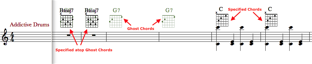

What I discovered is that there is a particular behavior which is problematic, which specifically is that chord symbols from other staves will appear in measures when viewing a part rather than the full score . . .
I call them "ghost chords" . . .

In my experiments, I had what one might call (a) instruments with no leading chords and (b) instruments with trailing chords, where for example the native NOTION drum set had chord symbols for the beginning measures but no chord symbols afterward, while the Addictive Drums staff had no leading chord symbols but had trailing chord symbols; and this combination behaved badly . . .
NOTE: In this context, "leading chords" are chord symbols that appear in the measures before actual notes start appearing; and "trailing chords" appear when the actual notes occur. For example, if there are no notes in measures 1 through 10, then chord symbols appearing in those measures are what I call "leading", while if the actual notes start in measure 11 and continue for a while, chord symbols that begin in measure 11 and continue through subsequent measures are what I call "trailing" chords . . . ]
TIP: If you are following the rule (see above) and you have have chord symbols on the drum staff but nowhere else, then uncheck the Show Hidden Items option on the View menu so you do not see grayed chords. These types of grayed chords are not ghost chords, because they are specified chords which were hidden but via the Show Hidden Items option being checked are shown in gray. Ghost chords are chords from another staff, and they appear gray, too; but you cannot hide them or delete them from a part staff, because they are virtual. The only way to delete them is from the staff where they were specified . . . ]
