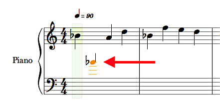

HOW TO MOVE A NOTE WITH AN ARROW KEY
This appeared to be a logical activity even though I do not recall using it . . .
I did two experiments, and the second one solved this part of the puzzle . . .
You need to select the note, which will cause it to turn a different color, which here in the sound isolation studio is orange or something thereabout . . .

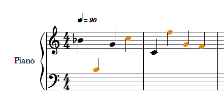

Once you have the note selected you can move it upward or downward with the respective arrow keys, but you cannot move it leftward or rightward . . .
You also can select a set of notes--which can be contiguous or otherwise--and move them as a set or group upward and downward with the respective arrow keys . . .
There is a way to navigate from note-to-note using arrow keys, and as best as I can determine the strategy is to use an arrow key to move the "playback" cursor to the desired note and then to press the "Return" key . . .
Pressing the "Return" key selects the note, and then you can use the up arrow or down arrow to change the pitch of the note . . .
Since I am a mouser, doing any more of these types of keyboard-only experiments is more than I can tolerate, because for me it's beyond awkward . . .
Navigating with a keyboard should be explained in the NOTION User Guide . . .

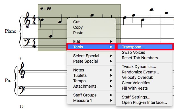

HOW TO TRANSPOSE A SELECTED SERIES OF NOTES
The keyword is "selected", but it's a different type of selecting than the type that turns notes orange . . .
There might be a way to select a subset of notes using only the keyboard, but as noted (see above), I have exceeded my tolerance for keyboarding, hence will not even try to discover how to do it--presuming there is a way to do it with only the keyboard . . .
Instead, when I want to select sequential series of notes or measures, I do this by dragging-and-dropping the mouse cursor or pointer to "encircle" or "lasso" the respective notes and measures . . .
Once this is done, I right-click the mouse to activate the context menu, where there is a context menu item named "Tools ", which I click to see the fly-out submenu where the "Transpose . . ." fly-out submenu item is found, which I click to get to the "Transpose" tool . . .

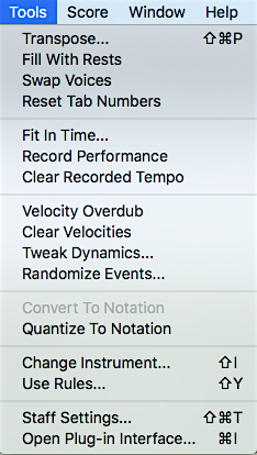

As with many of the functions and features of NOTION, there is a way to navigate to the "Transpose" function via a keyboard, where in this instance you will find a "Tools" menu, and it has a "Transpose . . . " menu item . . .
For reference, the "Tools" menu has some of the same menu items as the relevant context manu, but the "Tools" menu has a few additional menu items that are not on the context menu . . .
