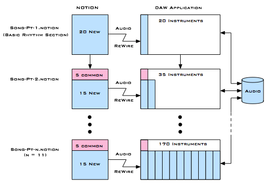

The key to this strategy is to use a Digital Audio Workstation (DAW) application for producing, mixing, and mastering . . . As shown in the following diagram, you begin with a NOTION score that is the Basic Rhythm Section for your composition; and you do this in NOTION running by itself. Save the NOTION score with a meaningful name that has "-PT-1" as the suffix (for example, "Song-PT-1.notion") . . .
Once you have the Basic Rhythm Section the way you like it in terms of the various structural sections of the composition (verse, chorus, bridge, interlude, and so forth), you can exit NOTION and start the DAW application, followed by starting NOTION, which begins a ReWire session where the DAW application is the ReWire host controller and NOTION is a ReWire slave . . .
Do the mapping of instrument tracks in the NOTION mixer to ReWire channel pairs; connect it to 20 stereo tracks in the DAW application; and then record the NOTION generated audio as soundbites or raw audio clips in the DAW application . . .
At this point, the NOTION generated audio is stored in the DAW application project on a hard drive as high-quality raw audio and is available on the 20 tracks in the DAW application mixer . . .
Save everything, and then do a "Save As . . . " of the NOTION score to create a synchronized clone, which you will name for example "Song-PT-2.notion" . . .
I usually keep 5 of the instruments in the NOTION score common so that if I want to work with NOTION by itself there are reference instruments (bass, kick drum, piano, melody instrument, counterpoint instrument). This is flexible, but as a rule I keep 5 instruments common most of the time . . .
NOTE: The outputs of the tracks in the NOTION Mixer need to be routed to ReWire channel pairs when you are working in a ReWire session, but when you decide to work with NOTION by itself then you need to change the output routing in the NOTION Mixer to "Output" so that you hear the audio. The rule on this is that in a ReWire session, the host controller is responsible for presenting the audio and the ReWire slaves only send their audio to the ReWire host controller, so you only hear (a) already recorded audio in the DAW project and (b) audio sent from the ReWire slaves. When NOTION is running by itself, it is responsible for presenting the audio, which requires changing the output for each channel you want to hear to "Output" (which actually is "Master" in the drop-down list, but so what) . . . ]
At this point, you can start working in ReWire sessions, since the audio for the already recorded instruments now is in the DAW application. The presentation of audio is handled by the ReWire host controller, which is the DAW application . . .
When you are working on "Song-PT-2.notion", 20 of the instruments are in the DAW application, but you have 15 new instruments that are sending their audio to the DAW application, so (a) you hear everything but (b) you can control what you hear via Solo, Mute, and so forth . . .
Once you finish the work on the next set of 15 instruments, you can record them as soundbites in the DAW application and then clone the NOTION score to create "Song-PT-3.notion", where you can add another 15 instruments; and so forth and so on . . .
When the total number of tracks in the DAW application is around 50, I like to start doing submixes of different instrument sections, where for example I might do a submix of ensemble woodwinds to combine several individual woodwind instruments into a section, where the submix, which is one stereo track in the DAW application mixer, replaces perhaps 5 to 10 separate woodwind tracks. The original audio for the 5 to 10 woodwind tracks is stored on disk, but it is replaced in the mix by a single stereo submix track. This reduces the number of tracks in the DAW application mixer and keeps it manageable. Effectively, a submix is a
layer; and you are building a song in layers, because it is not practical to have 100 or more tracks in a DAW application mixer, since (a) you cannot see all of them at once and (b) it is entirely too busy to be useful for high-level producing. In other words, you want to keep the total number of tracks in the DAW application mixer at a maximum of 50 at any given time, which is plenty for submix tracks and any solo instrument tracks that you want to keep separate so that you have more intimate control when producing; but even at 50 tracks it probably requires a bit of horizontal scrolling to get to all the tracks, so it tends to be better as the song progresses to do more submixes, which you always can revisit if necessary, because the original raw audio is there unless you intentionally delete it. Most DAW applications support non-destructive editing in one way or another. When you do a submix, the various effects are applied, hence this also makes more system memory and resources available when a single stereo submix track replaces a set of tracks (monaural and stereo) that have separate effects on a per track basis . . .

I keep the NOTION scores for a song in a common folder, and by following a few simple rules it is possible and practical to make changes as the project develops. Ideally, you want to determine the overall structure (verse, chorus, bridge, interlude, and so forth) when you are doing the Basic Rhythm Section, which for a
Classical composition might be a "Sketch" . . .
However, it is possible to change the overall structure of a composition; and since you have all the NOTION scores, you can recreate either (a) the entire composition or (b) selected parts of the composition, which certainly can include making a few revisions to specific instrumental parts as the composition progresses, where you just need to open the NOTION score where the particular instrument appears and then you can edit it and record a new soundbite in the DAW application for the particular instrument, which is something I do occasionally when I think a specific note for an instrument needs to be changed . . .
For real instruments and singing, this is done via overdubbing, but the concept is the same; and if you decide to add a new verse, you can add the music notation and record the new NOTION generated audio after doing a bit of cutting and pasting in the DAW project to add the required number of measures. Then, you just need to overdub the real instruments and singing for the new verse, which is what I did with "Feel Me" (The Surf Whammys) when I added a new third verse, where originally there were two verses with the last verse being a repeat of the first verse but a different real lead guitar and singing performance, where the strategy was to divide the real instrument and singing into two audio clips to preserve the original first, second, and last verse and then to insert blank measures in the DAW project for the new NOTION instrumentation and the overdubbed lead guitar and singing for the new third verse, which works very smoothly and for all practical purposes is transparent. If you did not know I added a third verse, I think it just appears that song always had four verses (three verses and a repeat of the first verse), which is fabulous . . .

Fabulous! P. S. Another advantage of this strategy is that you can have more effects plug-ins in the DAW project, because the DAW application is
not doing the virtual instrument music notation work, so it has more system memory available and operates under a different set of limitations and so forth . . .
NOTE: The total system memory is the same, but in a ReWire session done this way, the DAW application is focused and NOTION is focused, so whatever other limitations they might have are managed better. On the NOTION side when you are using VSTi virtual instruments, the VSTi virtual instrument engines use resources for processing, and this is another consideration. It is not simply a matter of system resources, and your Mac Pro (Early 2008) has the maximum amount of system memory other than doing a doubling thing, which can be done with system memory from Other World Computing but at a very expensive cost. 32GB of system memory is fantastic, really. At present, I have 20GB of system memory on my Mac Pro (Early 2008), and it works nicely. I need to upgrade the video processor, but it is a bit expensive, so it is on the list of "Things to Do" . . . ]
In other words, this strategy focuses NOTION on music notation and generating high-quality audio for virtual instruments, done in conjunction with any VSTi virtual instrument engines you are using in the NOTION score. All the effects work is moved to the DAW project, which is the optimal way to ensure that each application (NOTION and DAW) has the most resources available for what it needs to do . . .
As a general rule, I save everything frequently and about every hour or two exit the applications in the ReWIre session and then start a new ReWire session. This clears all the ReWire buffers and starts everything in a pristine state. It takes perhaps 5 or so minutes, and it avoids problems . . .
