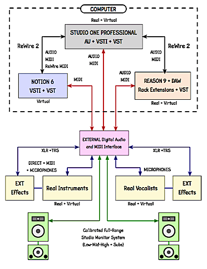

This is a high-level diagram (see below) of what I consider to be the complete digital music production system, which to the best of my knowledge includes everything that one can do . . .
Both parts (Virtual and Real) can be elaborate and vastly complex, but they also can be very simple . . .
Here in the sound isolation studio, the Real parts mostly are one microphone, electric guitar with pedal rig, and a KORG Triton Music Workstation, where the latter two are run directly to the MOTU 828mk3 Hybrid external digital audio and MIDI interface, which in turn connects to the DAW application for recording and playback . . .
It could be more elaborate, but the sound isolation studio is 6 feet wide by 7 feet tall and 12 feet long, so there's not a lot of space, which is fine with me . . .
