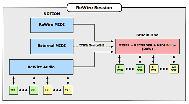

Over the past few weeks, I have been exploring the new ReWire MIDI functionality in NOTION 6 and Studio One Professional 3.5.5; and this completes the big picture for ReWire . . .
THOUGHTS ON NOTION 6 AND STUDIO ONE PROFESSIONAL 3.5+
It's very important to understand the differences in External MIDI and ReWire MIDI . . .
For practical purpose, every Digital Audio Workstation (DAW) application that supports ReWire also supports interacting with NOTION External MIDI staves; and this is done via Virtual MIDI Cables, which on the Mac are provided by Audio MIDI Setup and are part of Mac OS X; but on Windows machines, establishing a Virtual MIDI Cable requires using a third-party Virtual MIDI Cable utility program . . .
These are the two most frequently used Virtual MID Cable utility programs for Windows:
LoopBe1 (nerds.de)
virtualMIDI (Tobias Erichsen)
In contrast to doing External MIDI, doing ReWire MIDI does not require a separate Virtual MIDI Cable; so it's easier to do ReWire MIDI . . .
At present, the disadvantage to using ReWire MIDI is that as best as I can determine, Studio One does not record the MIDI sent from NOTION over ReWire MIDI buses and channels; but while this might be the case, the solution when you need to record MIDI sent from NOTION in Studio One is to use External MIDI staves for this specific functionality . . .
You can mix and match ReWire Audio, External MIDI, and ReWire MIDI in a NOTION 6 score and Studio One song project; so you are not limited in using just one of these technologies . . .
For reference, at present the only time I need to work directly with MIDI in the Studio One MIDI Editor is when I am using Realivox Blue (Realitone) as a female virtual soprano; and the reason is that Blue sounds most human and realistic when she is singing legato, which in turn requires the durations of notes to overlap. This can be done only by editing the MIDI notes, and it's consistent with the general concept of legato, which is a continuous type of singing where notes flow from one into another, hence the overlapping note durations . . .
[[/iNOTE: You also can do this in NOTION 6, but it's more precise when you do it in Studio One with the MIDI Editor. The strategy I use at present is to start with NOTION 6 and use music notation with Realivox Blue, which runs in Kontakt 5. So Kontakt 5 is hosted in NOTION 6. Then when the phonemes and melody are starting to sound good, I transfer the notes to Studio One as MIDI, and then switch to doing the precision tuning in the Studio One MIDI Editor. When that is done, I transfer the MIDI from Studio One to NOTION 6, where it's converted to music notation. I can adjust note durations in NOTION 6, but the real precision occurs in the Studio One MIDI Editor. When all that is done, I start working on the generated audio in Melodyne (Celemony), which is yet another way to fine-tune the way Blue sings; and with Melodyne I can create custom echoes and modify or enhance phonemes to add emphasis or increased enunciation to the starts and ends of phonemes, which is important for clarity. In some respects, it's a bit complex, but the result eventually sounds natural. I write "eventually", because there is a steep learning curve to using Realivox Blue, and at present I continue to be in learning and experimental mode with respect to Blue. What in the beginning took days now takes hours, so I am making good progress. The best way to understand this is that Blue does exactly what you tell her to do, which in turn maps to needing to understand what to tell her to do; and this is the aspect that is not so intuitive, where an example is singing "i" (sounds like "eye"). There is no "i" vowel in the Realivox Blue phoneme vocabulary, and "i" actually is a diphthong which is the combination of "ah" followed by "ee". Who knows that stuff? I know some of it, but it's a different language where words are "spelled" phonetically in the Realivox Blue scripting language; so instead of writing words the way they are spelled in English, you need to "write" the words the way they actually sound. It makes sense after a while, but it requires a lot of learning, experimenting, and so forth . . . ]

I need to verify a few things; but if it works the way I think it works, then I can use one or two instances of SampleTank 3 for all the ReWire MIDI staves in the NOTION project that are playing various SampleTank 3 VSTi virtual instruments . . .
I did another experiment to determine whether it's possible to have several NOTON 6 subscores without needing to have a separate Studio One project for each one; and this works nicely . .
The strategy is to use a different set of ReWire MIDI buses and to have a separate set of AU and VSTi virtual instruments for those ReWire MIDI buses in the Studio One project (a.k.a., "song") . . .
Doing a bit of thinking ahead, at some point it's a bit too complex to have a NOTION 6 score with 100 to 200 ReWire MIDI staves, although I am starting to think this might be possible . . .
So this is a variation of the Digital Performer and NOTION "layer" strategy, except that instead of the NOTION 6 subscores having only a handful of VSTi virtual instruments, the AU and VSTi virtual instruments are hosted in Studio One, and the NOTION 6 subscores have 16 or more ReWire MIDI staves . . .
Both strategies work with layers, but the ReWire MIDI with NOTION 6 and Studio One strategy has more staves for music notation in each NOTION 6 subscore, which is simpler and more straightforward . . .
The high-level perspective is that while it's interesting from the standpoint of software engineering to make sense of all this computer stuff, ultimately I want to create songs, not to devote most of my attention constantly to messing with computer stuff . . .

I did an experiment using "Surf Zot" where I started with a NOTION 6 score that had the same SampleTank 3 (IK Multimedia) VSTi virtual instruments as were hosted in Studio One in the previous post. Michael Myers (a.k.a, "TENSiViTy") used a similar technique in his recent topic, and I like the technique; so I did this experiment to see how it works with ReWire MIDI staves . . . :)
Then I sent the notes to an empty Studio One Professional 3.55 song, which worked nicely and got the MIDI into Studio One . . .
The "Send Notes to Studio One" process also created the Studio One Instrument Tracks for the respective SampleTank 3 (IK Multimedia) VSTi virtual instruments, which is very nice . . .
I changed the track colors, but the NOTION track names were used, which also is nice . . .
After some experimenting, I discovered how to save the various SampleTank 3 instruments as presets in a folder named "SW Presets"; and this saves time for commonly used SampleTank 3 instruments, although technically the instruments I use are from Sample Tank 2 and are "legacy" instruments. I like them; so these are the ones I use . . .
Having the particular instruments saved as presets in the "SW Presets" folder saves time when configuring SampleTank 3 in Studio One and NOTION; so no matter which way I decide to do the SampleTank 3 hosting, the configuration work is easier and faster . . .
Next I cloned the NOTION score; created 9 ReWire MIDI staves; copied the music notation from the VSTi staves to the corresponding ReWire MIDI staves; and then deleted the VSTi staves, at which point the music notation was on ReWire MIDI staves, but there were no VSTi virtual instrument staves in the cloned NOTION score . . .
The VSTi virtual instruments are hosted in Studio One, and there is MIDI sent previously from NOTION to play the instruments; so the cloned and updated NOTION score is there only for visual cues . . .
There is music notation on the ReWire MIDI staves in the cloned NOTION score, but there are no instruments hosted in the NOTION score; so NOTION has a very small CPU and Memory footprint . . .
There are so many ways to do all this stuff that making sense of it requires a diagram and a worksheet; so I am going to draw a diagram and put all the information in a worksheet, with the goal being to define a set of rules similar to a flowchart to provide information on when to use each strategy . . .
The fascinating aspect is that you can use a combination of strategies rather than only one strategy . . .
When you add Reason (Propellerhead Software) to the strategies, it adds several more ways to do everything; since now Reason can host VSTi virtual instruments and VST effects plug-ins . . .
And there there are real instruments and real vocalists . . .
In some respects, it's as complex as it is mind-boggling; but the important aspect is that there are particular strategies for each scenario one encounters in digital music production; and this includes recording real instruments and real vocalists . . .
I refer you to the updated diagram of the "Complete Digital Music Production System" for a few clues . . .
Complete Digital Music Production System ~ March 2018
The most important aspect of this Complete DIgital Music Production System is that when I need to do __________________, there is always at last one way to do it; and in many scenarios there are at least two ways to do it, whatever "it" happens to be . . .
This is a high-level diagram of the system; but to the best of my current knowledge, it covers every possible scenario . . .
I include Reason (Propellerhead Software); because Reason has unique capabilities that complement the capabilities of NOTION and Studio One . . .
There are things you can do in Reason that cannot be done easily any other way, so it's all good . . .

I added an Interlude to "Surf Zot" in a ReWire session with Studio One Professional as the ReWire host controller and NOTION 6 as the ReWire slave, using ReWire MIDI staves in the NOTION 6 score and AU and VSTI virtual instruments and effects plug-ins hosted in Studio One Professional, which is very easy to do. The YouTube video shows the music notation, but Studio One Professional is controlling the audio and the ReWire session. NOTON 6 provides the music notation and sends it to Studio One Professional via ReWire MIDI staves . . . :)
I want to have a bit of FUN with echo units and spacetime in the Interlude, so this is the basic version of the Interlude . . .

There now are 11 AUi (Mac only) and VSTi (Mac and Windows) virtual instruments hosted in the Studio One song, which along with the effects plug-ins is at the upper limit that Studio One Professional 3.5+ can handle on the Mac Pro here in the sound isolation studio . . .
Consequently, I am switching focus to defining the system for having a lot of virtual instruments, which is a key aspect of the the Studio One and NOTION "ReWire MIDI" strategy . . .
The plan is to record the audio generated by the Instrument Tracks to Audio Tracks and then to export the Audio Tracks as "stems" (or audio clips) . . .
Then I will create a new Studio One song and import the "stems", which then makes another 10 or so Instrument Tracks available, because the new Studio One song will start with only the imported "stems" . . .
I also will create a new NOTION score with 10 ReWire MIDI staves to use for additional instruments hosted on Studio One Instrument Tracks . . .
If this works--and I think it will--then it's similar to the system I have been using for years, which has a set of NOTION subscores with 10 or so staves per score that I use to create layers of instruments for a song . . .
The plan is to have 10 or 20 Studio One songs and 10 or 20 NOTION subscores, which with a bit of submixing Audio Tracks will map to the capability of having 100 to 200 instruments--including Realivox Blue (Realitone)--for a song; and I will do something similar for real instruments and real singing . . .
I need a lot of instrument and vocal tracks--mostly for "Sparkling" instruments and vocals--and when nearly everything is done by one person with a combination of virtual instruments, virtual voices (Realivox Blue), a few real instruments, and real voices, it has to be done in layers, which is fine with me . . .

This new Studio One Professional ".song" is the second layer, where the previous iterations are the first layer; so now there are two high-level layers, each of which is a separate Studio One Professional ".song" . . .
I added two more ReWire MIDI staves to the existing NOTION 6 score, but I put them on ReWire Bus 2 to keep them separate from the 11 ReWire MIDI staves that are used with the first layer, which are on ReWire Bus 1 . . .
This way, I see all the music notation for both layers; but only the two, new ReWire MIDI staves are playing Instrument Tracks in the new Studio One Professional ".song" for the second layer . . .
This might appear to be vastly complex, but it's actually very easy to do and does not take a lot of time to do . . .

The NOTION 6 score now has 15 ReWire MIDI staves, and the additional instruments and first set of submixed instrument stems are in a new Studio One Professional 3.5.6 ".song", which in this version of "Surf Zot" has four Audio Tracks loaded with the submixed "stems" from the first Studio One ".song" and four new Instrument Tracks (two pairs of SampleTank 3 lead guitars) . . .
This is very easy to do, and everything is done in ReWire sessions where Studio One is the ReWire host controller and NOTION 6 is the ReWire slave . . .
The NOTION 6 score only has ReWire MIDI staves . . .
The imported stems (submixed audio tracks from the first layer) and four Instrument Tracks are in the Studio One ".song" for the second layer . . .
On the Studio One side, each layer is a separate Studio One ".song" . . .
In this system for developing songs, NOTION 6 provides the music notation on ReWire MIDI staves and sends the resulting MIDI to Studio One to play the AUi and VSTi virtual instruments hosted in Studio One . . .
There are several important benefits of this strategy:
(1) NOTIION 6 is responsible only for music notation and ReWire MIDI staves, which keeps the work NOTION 6 needs to do as simple as possible, which maps to low overhead with respect to system resource usage . . .
(2) At most, each layer of the song in Studio One is responsible for a reasonable number of Audio Tracks and Instrument Tracks, as well as a reasonable number of AU and VST effects plug-ins, which is well within the system resource usage capabilities of Studio One . . .
(3) Since all the work is done in ReWire sessions, I have immediate access to the music notation and everything on the producing and mixing side with Studio One . . .
