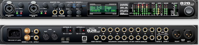

There are a few requirements, and perhaps the most important requirement is to have an external digital audio and MIDI interface like a MOTU® 828mk3 Hybrid, MOTU® 828x, PreSonus® Studio 1824c, PreSonus® Quantum 2626, or PreSonus® Quantum, depending on which one works best with your computer . . .
[NOTE: This has two dual XLR + TRS microphone and guitar inputs, plus eight TRS inputs and outputs. If you need more, then there are additional MOTU devices that add more TRS (tip-ring-sleeve) and XLR inputs and outputs. For reference, a stereo or two-channel cord is TRS (tip-ring-sleeve). XLR microphone cables costs about $20 each, which is separate from the cost of the microphones. XLR is monarual but balanced, hence three wires . . . ]
MOTU® 828mk3 Hybrid Digital Audio and MIDI Interface

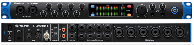

[NOTE: The PreSonus unit has the advantage of dual XLR+TRS inputs . . . ]
PreSonus® Studio 1824c Digital Audio and MIDI Interface

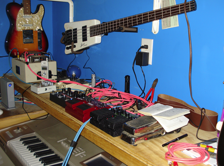

If you add a set of effects pedals and a Fulltone Echo Unit for electric guitar, then this can add $5,000 or more to the total . . .
[NOTE: There are motion pedals on the floor, although not shown in the photo. Observe all the audio cables, typically "monaural guitar cords (TS, tip-sleeve)" or stereo/two-channel guitar cords (TRS, tip-ring-sleeve)", each of which costs from $5 to $20 depending on length, where the shorter cords are called "patch cords" or something similar. Since TRS cords work for monaural, I get TRS cords; but since I have a custom modded Stratocaster with two separate and independent output signals, I use a 1/4" male TRS to dual 1/4" male TS cord splitter. The Stratocaster has a female TRS output port rather than a typical female TS output port; so the splitter cord takes is from two-channel to a pair of single-channels. It's not stereo, but instead is two-channel where each channel is monaural. The Really Big Knob controls the six-position Rothstein Guitars Varitone device . . . ]
The Fabulous Fifty Million Dollar Trinaural Stracaster® ft. The Really Big Knob™

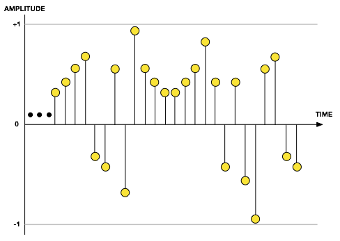

On the software engineering side, this is the way a lot of audio effects are programmed--in particular flanging, echoes, and in some instances controlling and enhancing tones and textures . . .
This is something I discovered when I became interested in designing and programming Reason Rack Extensions, where the basic concept is that there is a steady stream of samples delivered, which in colloquial terms are called "lollipops" and visually look a bit like a Tootsie Roll Pop--a piece of round candy on a stick . . .
Stream of Lollipops
Rotate the stream of lollipops and map them to the back-and-forth motion of the paper cone of a loudspeaker (a.k.a., "woofer"); and this is what actually happens:
Consider a simple echo or digital delay unit . . .
The original sound--a series of samples--is delivered as a stream, and you make a copy of it and then after a small delay you add the copied stream to the ongoing original stream . . .

On the software engineering side of creating effects, the individual audio units are "samples" or "lollipops"; but in Melodyne, the units are called "blobs" . . .
[NOTE: Melodyne can export "blobs" as MIDI, which then can be imported to NOTION and transformed into music notation and exported from NOTION as MusicXML, which is another powerful capability of Melodyne and NOTION; but Melodyne runs in Studio One, not in NOTION, so you need Studio One, Melodyne, and NOTION to do this . . . ]

Think like a software engineer, and remember that internally at the deepest and most primitive level, it's all about lollipops, where Studio One and NOTION are lollipop factories . . . :+1
Each staff corresponds to a motion you would do manually to control the Amp Simulator . . .
If you want to have eight Amp Simulator settings, then have eight staves to represent the eight Amp Simulator settings; and put notes on the respective staff that has the desired Amp Simulator settings at that moment in time . . .
Remember that it's all lollipops, samples, and blobs arriving on a discrete timeline . . .

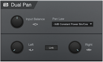

PANNING
I did this when I was exploring how to control panning within NOTION; and this led to some very useful information, including the fact that NOTION does not have simple panning controls, although they are capable of being nearly simple panning controls . . .
This also happens in Studio One and most of other Digital Audio Workstation (DAW) applications for so-called "panning" controls for stereo tracks--unless "splitters" are used . . .
[NOTE: This is the "splitter" used in Studio One, and it separates the two-channels of a stereo Audio Track so that each monaural channel has true panning . . . ]
Dual Pan Control ~ Studio One
Dual Pan Control ~ Studio One Professional 6
The problem is that most "panning" controls for stereo tracks actually are balance controls, hence for panning are completely and totally useless, because they do not do proper panning . . .
Instead, they are volume controls for the respective left and right channels and move the actual location of nothing . . .
For a monaural track, a panning control moves the location of the audio to one side or the other, as well as locations in-between; so if you move the monaural panning control to far-left. then the sound is heard at far-left only, and so forth . . .
In great and disturbing contrast, most stereo "panning" controls actually are balance controls and do no panning at all . . .
Discovering this was one of the important bits of information I discovered when I was exploring panning; and it's a significant bit of information . . .
FACT: A balance control only changes the respective volume levels of the left and right channels of the stereo (two-channel) audio, which for ruthlessly doing producing and audio-engineering makes balance controls totally worthless.

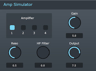

With this in mind, there are five native effects in NOTION 6:
(1) Amp Simulator {Amplifier, Gain, Reso, High Pass Filter, Output}

The flanging or phasing on the electric guitar, as well as the vibrato, is done with the tabbed electric guitar using the unique articulations and playing styles of the tabbed electric guitar in NOTION . . .
As best as I can determine, there is no documentation in the NOTION User Guide for the various parameters and options of the NOTION effects; but some of them are self-obvious . . .
So far, I notice little, if any, differences in the Amp Simulator types; and I have no idea what "Reso" happens to be . . .
A few of the other parameters make little obvious sense; but with more experimentation this might become clearer . . .
I am guessing "Reso" is short for "Resonance", but none of its values maps to anything I would call "resonance"; so that part of the Amp Simulator is a bit confusing . . .

The Reso is the resonance. Basically this works in conjunction with the HP Filter. The resonance creates a feedback of the filter and sort of amplifies certain frequencies and harmonics that are allowed to pass through the HP filter. Depending on the period of feedback, separate oscillation can occur. The short answer is the sound will become more abrasive and trebley with a higher HP Filter and increased Reso.
The Amp sim types change quite a bit once you start messing with the overdrive and the Filter/Resonance. My guess is that each "Sim 1,2,3 or 4" are actually different impulse responses modeling slightly different amp cabinets.
