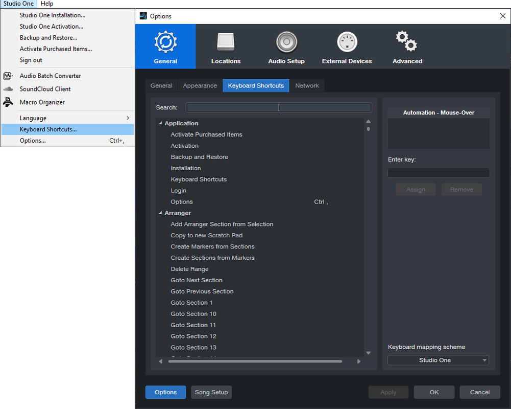

Keyboard Shortcuts:
Shows the full list of available Shortcuts but no Shortcut details.

kaygeeeff wroteKeyboard Shortcuts:
Please post a screenshot of what you see for Keyboard shortcuts.
Have you confirmed that the paths you have assigned match up with the locations on your hard drives?
