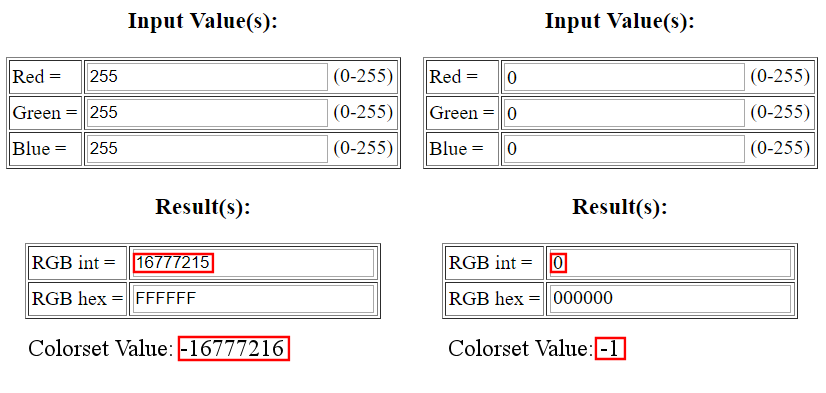

Sorry, still not understanding the math.
Here's the color, RGB info followed by their values that show in the exported .colorset file.
Can you show the math equations to convert each of the following? Thanks!
Black (0,0,0) = -16777216
White (255,255,255) = -1

That's the conversion code I'm using in in JS. Blue, Green, Red:
( (255 << 16) | ( 255 << 8) | 255) | 0xff000000 = # number for White
The math behind this page
https://www.shodor.org/stella2java/rgbint.html otoh is...
256*256*red+256*green+blue

I ran the conversion tool in the link you provided.
I understand the math conversion but couldn't understand why the value stored in the .colorset file is a negative number and a 1 added to the actual value.
Suggestion: If it's more difficult to export/import RGB values, another common practice would be to save them as Hex values.

I'm not sure what problem you're trying to solve. The colors store and recall correctly which all it needs to do for the limited purpose it serves.
The difference in the integer values in your image (other than the negative sign) is that that formula from that page uses 256, which explains why the numbers are shifted by 1. That may be what Java uses internally 256 instead of 255 as that page appears to relate to Java.
