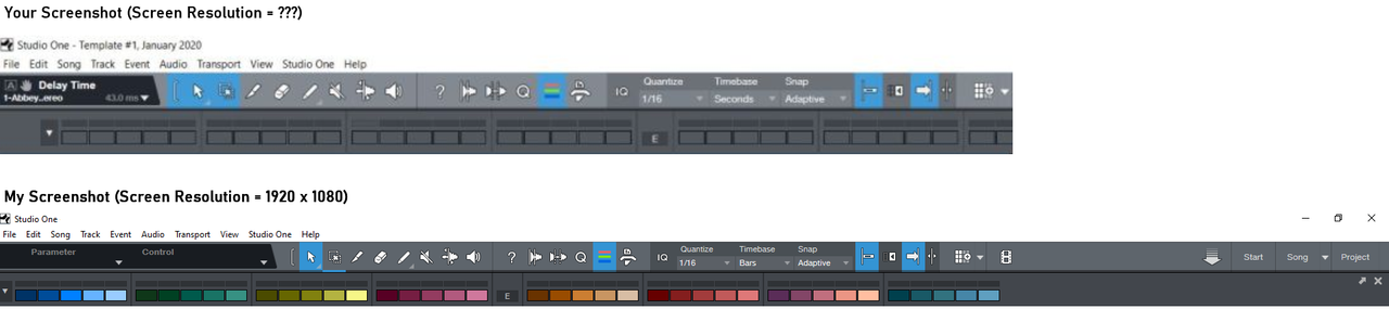

I downloaded the file and placed it in the scripts folder. When I open Studio One (4.6 Professional), I have the colors icon and the dialog box opens but there are no colors in the small rectangles where the colors should be. Any help would be appreciated. Thanks.

What's your screen resolution? I'm not sure if the screenshot you posted is cropped but not all 8 groups of colors (5 per group) are being displayed.
If it's not a screen resolution issue, try loading the "Default Set" from the dropdown menu:

My resolution is set for 1920 x 1200 (recommended) and yes, all 8 of the color groups are displayed. When I try loading the Default Set, nothing happens. (I tried uploading a larger jpg and got a dialog box telling me the maximum size had to be no more than 800 pixels wide and 600 pixels high). Thanks for such a quick response, Trucky.
