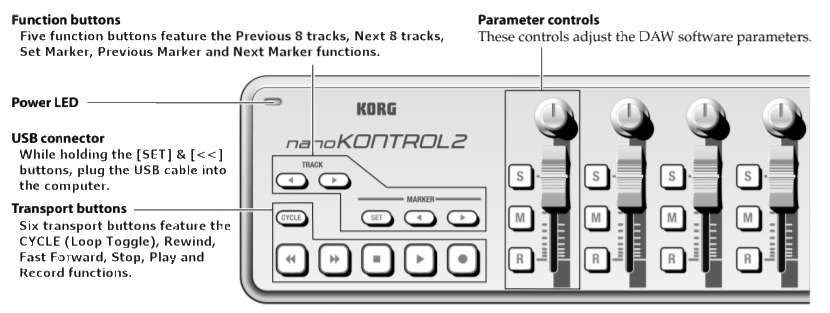

Reviving this thread, got a question!
Today I tried setting up my nanokontrol2 with current version of S1, it went fine (midi information is being sent/received) but it doesn't seem to highlight tracks that are being controlled in S1 itself (I have a PT also and there you can see the 8 tracks on your DAW console that are being affected, and you can mute, solo, control fader, pad etc., in fact mix window would jump to those particular tracks when you press "track" left/right buttons on controller) Is this feature missing in S1 or is there some kind of option I didn't find? Unfortunately, the former would make NK2 not particularly useful for me in S1... I like writing automation with it and seeing which tracks I'm working with.

All the functions for the buttons and faders should work however you are correct that the mix window and channel focus in Studio One doesn't change when banking. You'll need to use the mouse or keyboard shortcuts to scroll there.
